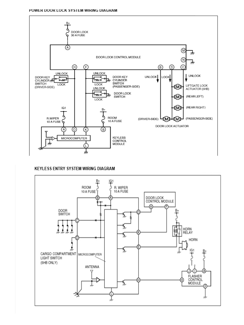

My car hasn´t a keyless entry system. Only open with key. I want install an universal central locking with remote but I have not the door relay module ( the green one) wiring. I have the wiring for Protege model but I think it is not the same. I see more wires in my module than in the protege drawing. Mine is a 323 F BJ of december 1.999.
Please, any help with this issue? Someone with the wiring for my model?
Thanks.

PostPosted: Wed Jan 22, 2020 10:41 pm
Maybe this will help:-

Thanks for the reply.
I live in Spain, maybe is different for us. I have the protege wiring information, but not about my car. I have not remote, only key, maybe the owner before me, lies to me saying that only had key. I see more wires in my relay than in the drawing.
My car has 5 doors, not sedan. 1.999 year, 2.0TD.
I have many doubts about take the wrong wire...
Cheers.

Hello again,
Your model should have remote central locking facility already built in at the factory (at least the UK ones did!! :lol: ) so maybe you just need to obtain a remote fob (2-button) from Ebay and program it.
We can let you know the details to have a try.
