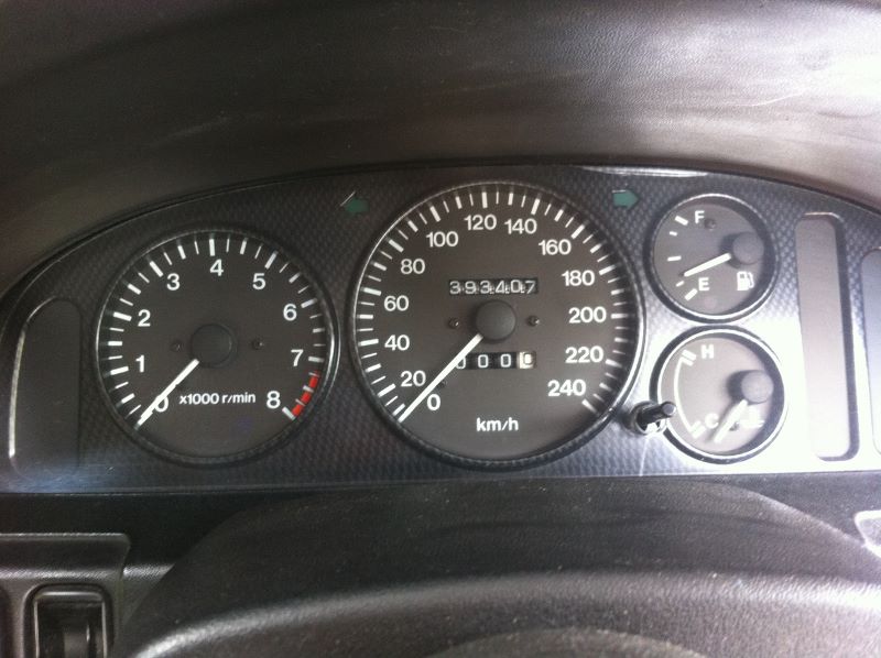

I was watching some youtube video's of Lantis/Astina/Probes/323F all doing power runs noticed all of them had 0-240km speedo's.
I only have a 0-180km speedo as that is the MAX allowed in Japan.
You guessed it I have to fit a 0-240km speedo.
Brought a second hand dash unit and swapped the speedo's between the two units.
Went for a run and the speedo is working as it should and accuracy is good.
And gained another 60kph :-) :D

Yes the 180kph speedo speed limited the car also but one disconnected wire and the needle and car went right to the stopper :D
Going to have a look at the spare speedo today to see if its easy to change the gauge to the right miles done.
Thanks
Craig
lantisv62500
PostPosted: Sun Mar 18, 2018 11:34 pm
Joined: Mon May 28, 2007 1:38 am
Posts: 124
Location: Auckland, New Zealand
Took the speedo out and altered the speedo reading to the correct one for the car.
Did a practice run on the spare speedo and then did the 240kph speedo.
Not too difficult at all. Just take your time and be careful :)

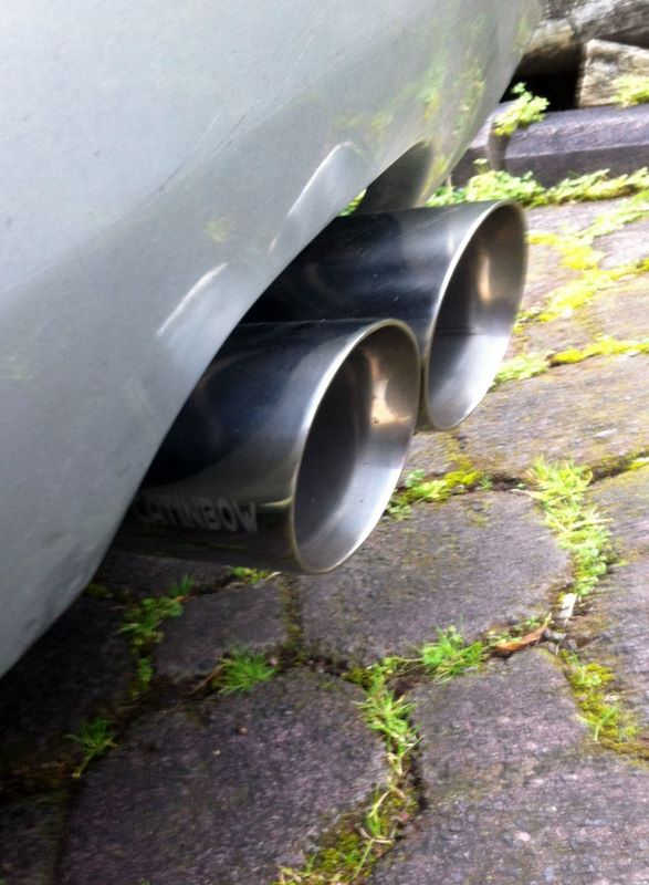

MUFFLER TIME.
Got back into looking for a new rear muffler.
The one I had built was starting to show its age and had needed a few minor repairs.
Have always wanted to try a Dynomax Super Turbo and on reading feedback on them (The biggest complaint was they were too quiet and build quality)
Now I wanted QUIET and on Amazon found Dynomax 17748 Super Turbo Muffler that looked perfect for the job. As it was a 2.5inch inlet and 2.5 outlet therefore I needed a dual tip exhaust also so ordered one of those too.
USA to NZ took 8 Days and I fitted them that day.
Was it worth it?
After 2 weeks of driving, it's lovely. (I am old and quiet is nice)
Nice rumble at idle and up to about 2K and then shes quiet. Really quiet.
Driving on the motorway or just cruising very very relaxing and great for a daily.
Performance I think is better than before also. Revs out much quicker that before.
The build quality could be better in that the inlet and outlet are only spot welded to the case.
Overall, excellent value for money (155NZ) and there is nothing in NZ at that price.
The tips are very nice too and have attached a photo.

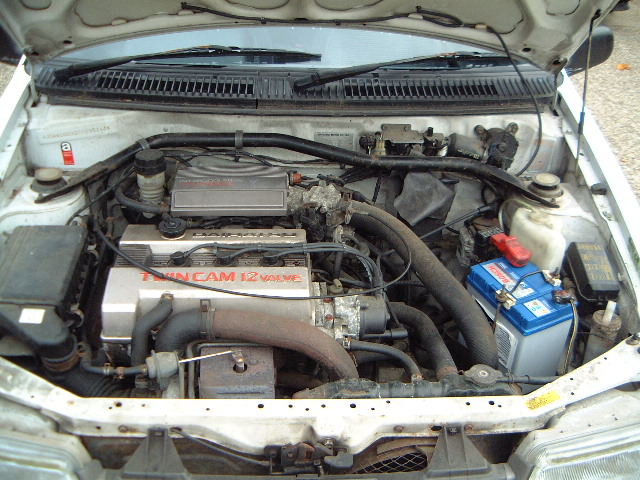

Well familiar with the CB80 (same thing as CB70 really) had one for 12 years now, a bit poorly with zero compression in one cylinder but bought one after getting rid of my ZXi which I regretted. Anyway an amazing engine and 150 easily achievable, are you on the Facebook group? Daihatsu Charade GTti owners?

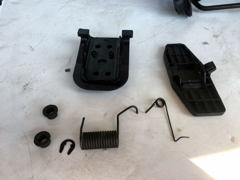

Accelerator pedal assembly.
Being 6ft 6inch can be a pain when it comes to cars.
Accelerator pedals are always not quite right and on a long trip cramps up the accelerator leg detract from the enjoyment of the drive.
I drove my daughters Mazda 3 and found the accelerator pedal position excellent. So much so I had a good look at its positioning. The pedal is much further in towards the firewall than the Lantis one.
So I modded the pedal assembly accordingly and now have a much more comfortable driving position.
I am already using the MX6 assembly which is much better build quality over the Lantis one (Metal base, bushings for the shaft, better/stronger spring and tilting pedal)
No fast idle when you stop with this assembly.

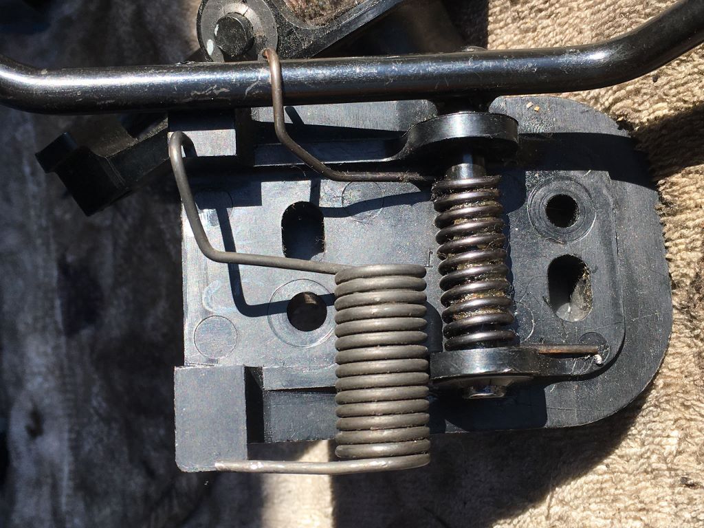

The photo below shows you the Pedal spring for the MX6 and the Lantis.

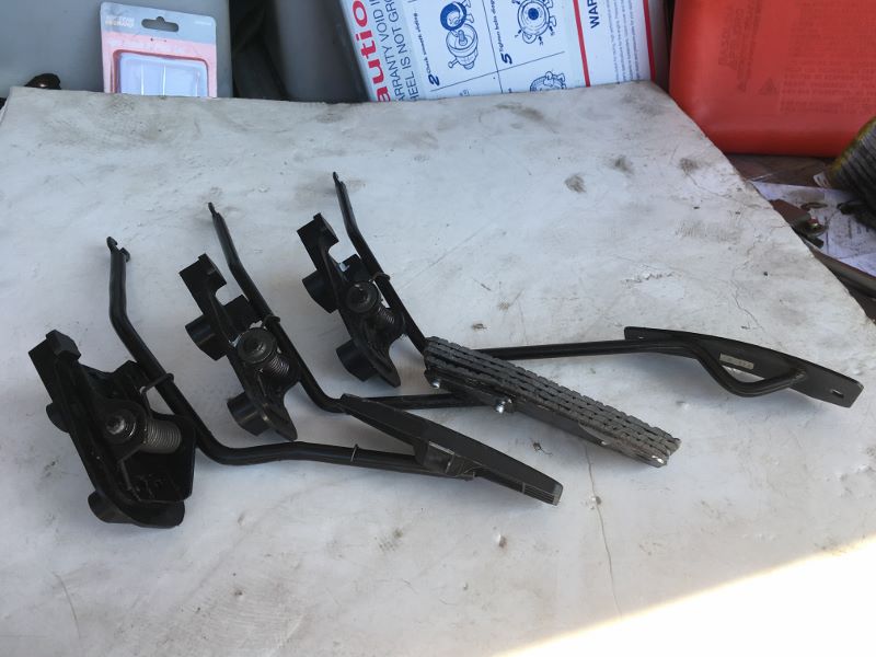

I used a old pedal assembly to find the correct height. Cut the shaft at about the right height and welded a plate on the end and then added layers of Deck tread onto the plate until I had the right height.
I then modded the MX6 Petal assembly accordingly.
The lefthand one is the final, middle is the finding the right height and the right is the original Lantis one.
Wish I had done that 20 years ago.

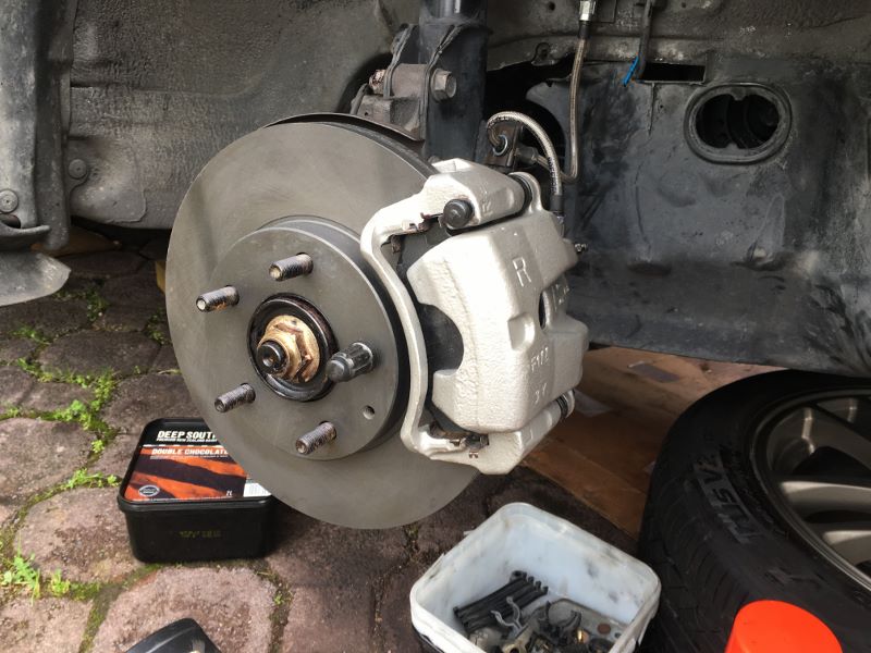

Brake hoses replaced with SafeBrake braided lines and calibers overhauled and painted.
Car has done 410,000km now and the brakes were needing a bit of work.
Brake booster failed and needed replacement, First pads worn and the brake lines needed to be replaced (starting to swell) Decided to do the seal's on the calibers and paint them while I had it all apart.
Disc's were just about worn out too so replaced them too.
Doing the Brake Booster was FUN - NOT.
Also replaced the one way valve in the vaccum line to the booster.
The car brakes very well :-) now.
PostPosted: Sat Sep 21, 2019 1:19 pm
It will roar on the roads again!Good work!
From where did you get the brakes hoses?And how much do they cost if i may ask?
Cheers!
lantisv62500
PostPosted: Sat Sep 21, 2019 9:01 pm
Posts: 124
Hi maZZda,
The brake lines are from a company called SafeBrake.com.au in Australia. (cost 185NZ)
Quality seems good and the fit up was easy and no mods required to fit.
Someone else on here had also used SafeBrake and said they required some modding to fit, so there maybe some work depending on the car.

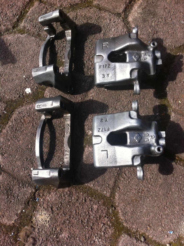

Photo of the Calibers and mounting bracket ready for paint. For some reason I can not find the painted photos?

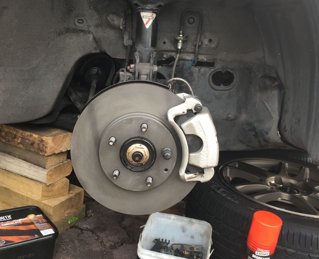

Plus another photo of the drivers front assembly

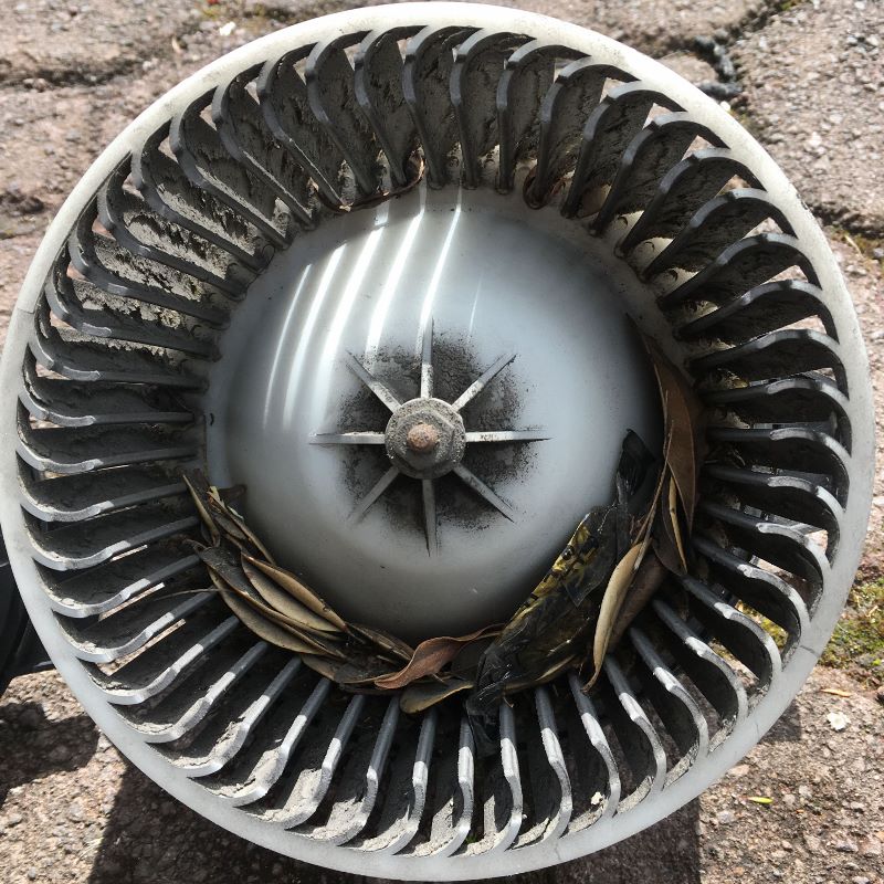

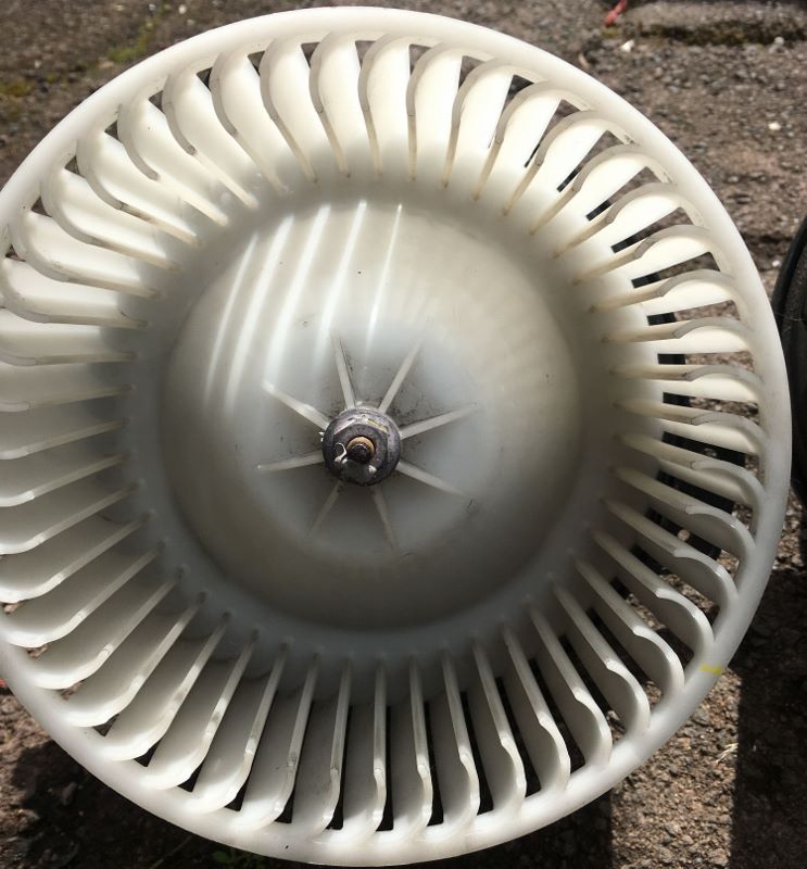

Air con fan noisy :(
The air con fan got noisy with a ticking noise.
Finally had enough of it and dropped the fan assembly out of its housing and look what I found.
Lots of leaves and a wrapper too. No wonder the fan was a bit noisy.
Cleaned it up
The fan is now nice and quiet and seems to have a bit more blow to it also.
All ready for the long hot summer.
PostPosted: Thu Oct 03, 2019 3:37 pm
lantisv62500 wrote:
Air con fan noisy :( ...Cleaned it up
Fans blades are effectively (more or less) airfoils of one sort or another. Any disruption to the smooth flow of air tends to cause drag and performance reduction. If you have a pedestal or desk fan, try cleaning its blades & grilles- you'll be astounded at the difference between clean and dirty ones.
P.S. good to see you back lantisv62500
