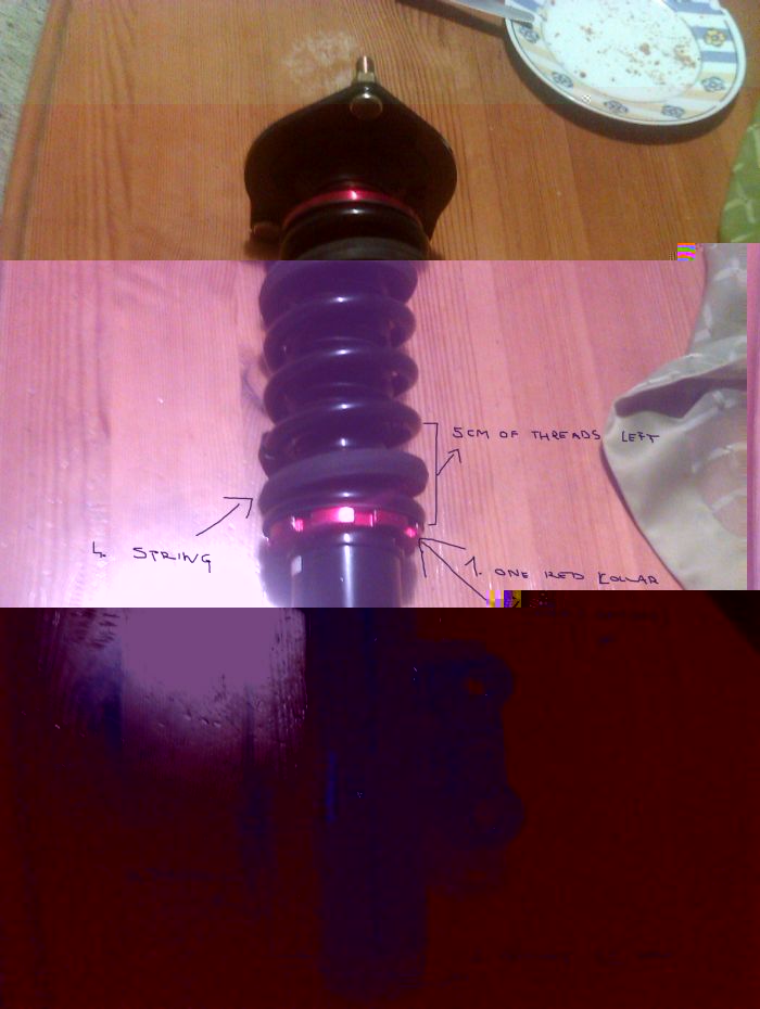

Today I received the BC coilovers V1...the same as yours... they put a big smile on my face got to say :lol: ... but I have a question for you... Does your BC's touching the CV joint? Becouse mine do and I still have 5 centimeters of thread left on them and I allready removed the black and one of the red locking collars... I don't know if I don't know how to adjust them correctly or is this the full potential of lowering them.... Hope you understood. Thanks

Hmm... I think I understood.
So... the height is adjusted on the body of the suspension. The body goes up or goes down in the black piece holding the stub axle. The collar you have when you remove the other two, goes up and stop when the spring of coilover is trapped (without forcing it) when the car is with the wheel on the air.
I really hope you understand what I mean. If you have any question, tell me. I'll try help you ;)

So I have them installed and positioned just like this (on the picture) ... Did I lowered it correctly?... and is this the full potential of lowering them ?
I hope the picture is helpfull :)
HughieW told me this is it... if I want to lowered it more I need to buy new shock and spring.

Yes... That's it! ;)
But... give 1 or 2mm of space between the coilover and the cv joint because, can spoil the CV Joint ;)
Look...

Ohh... OK thanks mate ;) ...appreciate the help... I was afraid I was doing it wrong :P ... Thank you again :D
