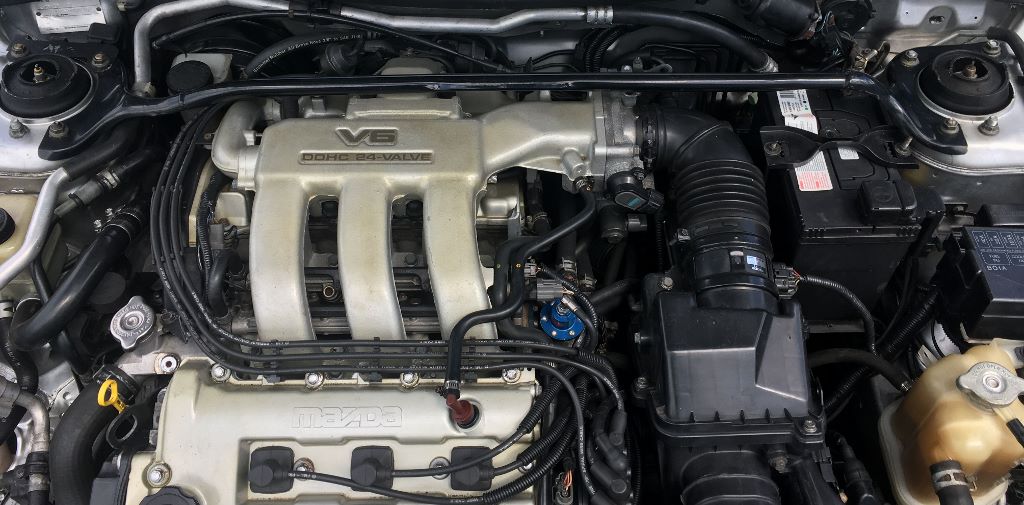

OLD STANDARD ONE.

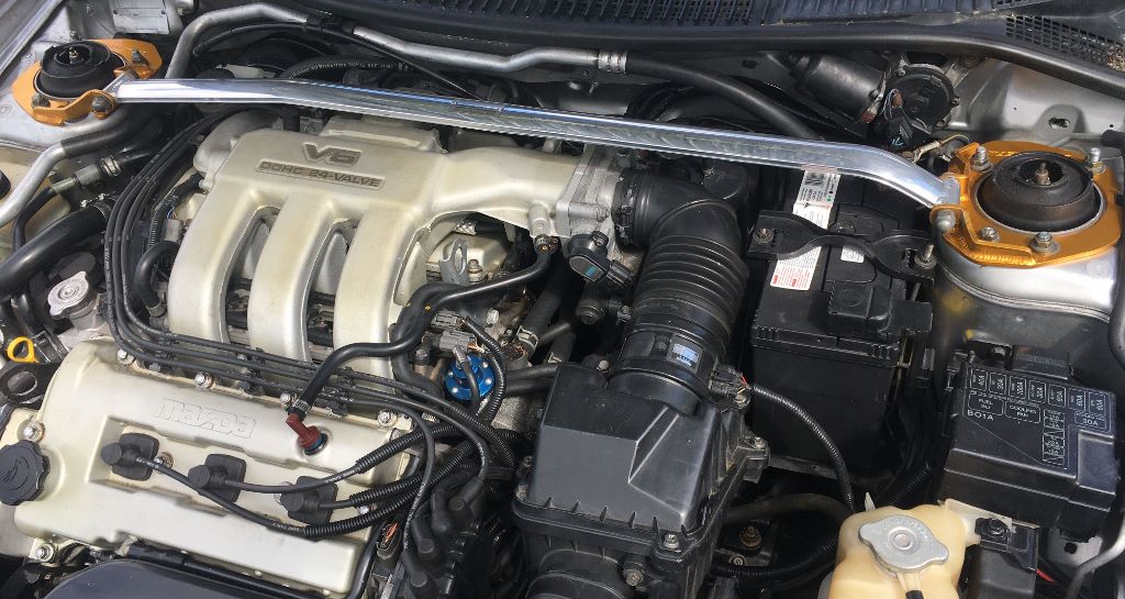

MAZDASPEED ONE
Adds a bit of colour. :D
UPDATE
I have been driving with the new strut brace for about 4 days now.
I didn't expect to feel too much difference if any as I already had the standard brace before this one.
Well, I'm happy to report there is a difference.
The front suspension is quieter over certain bumps on the motorway and the front just feels more solid?
In reflection the standard brace is not bolted hard down onto the top of the strut towers (there are nuts spacing the brace away from the top of the towers) and to honest it is a very light, flexible item.
The MS Brace bolts hard down onto the tops of the struts with very solid plates and it is not flexible.
Functional "Bling" - Who would have thought :-)
Has anyone tried a rear strut brace?
